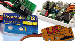

Pitch Controller
When underway while submerged, submarine models tend to “porpoise”. They cyclically rise and fall due to changes in the boat's pitch angle. A pitch controller is an electronic device designed to automatically keep a model submarine on an even keel when submerged. Pitch controllers, or angle keepers as they are sometimes called, are connected in-line between the receiver and the stern plane servo. The unit senses change in the boat's pitch angle and proportionally moves the stern planes to correct the boat’s angle back to level (zero bubble).
The first proper pitch controller was developed by Skip Asay in the early 1990’s. Its impact on the hobby was immediate. Rather than fighting the boat’s tendencies to rise and fall, the operator was now able to concentrate on maneuvering the boat itself. With the pitch controller maintaining level operation, scale patrolling at periscope depth was achievable by even the novice sub driver.
Over the ensuing years, pitch controllers have been refined and produced by several manufacturers. Most today rely on solid-state accelerometer technology to determine a model’s change in relation to true level. Unit size has been reduced as well enabling them to be installed in virtually all models.
Proper pitch controller installation is important to ensure the best results. Depending on the vendor, the pitch controller should be oriented in the boat along the horizontal axis and securely mounted. The unit is then set to register the boat’s zero position, or level. Care must be taken when setting zero so that the model itself is level, otherwise it will be over or under correcting depending on the error.
Once installed properly, the pitch controller will send input to the servos in response to the model's pitch. However, manual control of the stern planes is not forfeited. Pitch controllers accept manual input from the operator overriding the level sensor. When input is not being received, the pitch controller returns to autonomous operation.
