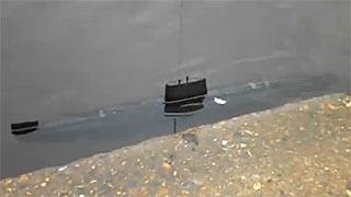

A Dynamic Diving System is one where dynamic forces are used to overcome a models' buoyancy. These forces consist of a sufficient forward speed in combination with a set of hydroplanes (forward or aft). In much the same way an airplane's wing creates lift by moving forward through the air mass, as a submarine moves forward through water with sufficient speed, the hydroplanes create a force that pushes the model below the surface. As long as the force is sufficient to overcome the buoyancy of the boat it will remain submerged.
There are both pros and cons to the dynamic system. Generally, a boat must make considerable speed to overcome its buoyancy. This can result in a less-than-scale looking dive. It also limits the ability to operate submerged at a slow speed. However, because of its inherently positive buoyant trim it has a built in failsafe in case of power loss. Once the forward motion ceases, the boat rises quickly to the surface, minimizing the possibility of loss of the model. It can be less expensive to build and maintain as well.

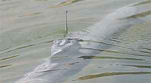

A Static Diving System is one where a model submerges by changing its overall buoyancy. This occurs through the use of an onboard ballast system. As a result, a model can submerge when it is stationary and operate below the surface at any speed.
Static diving systems usually vary a boats buoyancy through the displacement of water. The ballast system is built around a tank that contains a volume of air sufficient to float the boat. In order to submerge the boat, water is introduced into the tank. As the water fills the tank, the boat loses buoyancy to the point that it is negatively buoyant. In order to resurface, the water is then removed from the tank and replaced with air, making the boat positively buoyant again.
Static diving systems are more mechanically complex than dynamic diving systems and thus require more maintenance. They usually require extra safety features to prevent loss of the model in case of power or system failure. Ballast systems have been successfully designed using a number of different mechanical means to vary buoyancy. See our ballast system curriculum to learn more.
