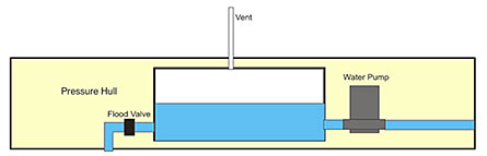

Low Pressure Pump Ballast System
The Low Pressure Pump Ballast System
is not a true static dive system, but rather
a hybrid of the static and dynamic dive systems.
In this system, a flood valve is opened and air leaves the ballast
tank through a vent. The vent typically exits
very high on the model, hidden as a periscope or
mast. Water enters the ballast tank from the flood
valve until the tank is fully vented, at which
time its buoyancy will be slightly positive and the
boat rides “decks awash”. With the reduced
buoyancy, the boat’s dive planes can now be used
to pull the boat under the water with
very little speed.
To surface, the flood valve is closed and the positive buoyancy of the model brings it back up to the “decks awash” state on the surface. A small low pressure pump then pumps the water out of the ballast tank, drawing in air from the surface through the vent mast.
The low pressure pump system is simple, very reliable and draws little current from the battery. The slightly positive trim of the boat is inherently safer. However, the vent must be above the surface to empty the ballast tank of water. And though it is closer than a dynamic dive boat, it is not a truly static diving system.
