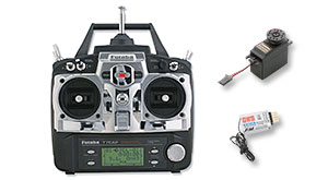

R/C submarines utilize three essential electronic components to affect control: a radio transmitter, a receiver and servos. These basic components are the same ones that have been used for years to control R/C airplanes, cars and boats.
Radio transmitters contain control sticks and switches which the operator manipulates to send commands to the model. The transmitter multiplexes all the commands into a single pulse-position modulation radio signal. In most cases, the number of control interfaces on the model dictates the number of channels the radio must provide. Dynamic diving submarines normally require three channels: throttle, rudder and stern planes. Static diving submarines require a minimum of four channels: throttle, rudder, stern planes and ballast system.
The receiver is mounted in the model and receives the radio signal through an antenna. It demodulates and demultiplexes the signal and translates it to the pulse-width modulation used by standard R/C servos or electronic speed controls (ESC).
Hard connected to the receiver, servos contain a small motor in a case that drives a control horn mounted on the top of the case. The control horn moves in response to the receiver command. The motion is transferred by a hard linkage to the control surface.
